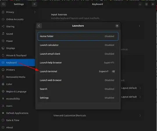

In Ubuntu 22.04 I did it by going to Settings -> Keyboard -> Keyboard Shortcuts -> Launchers -> Launch Terminal.
There I assigned it to Super + T.
Change super+t to open a terminal. Ubuntu Settings
