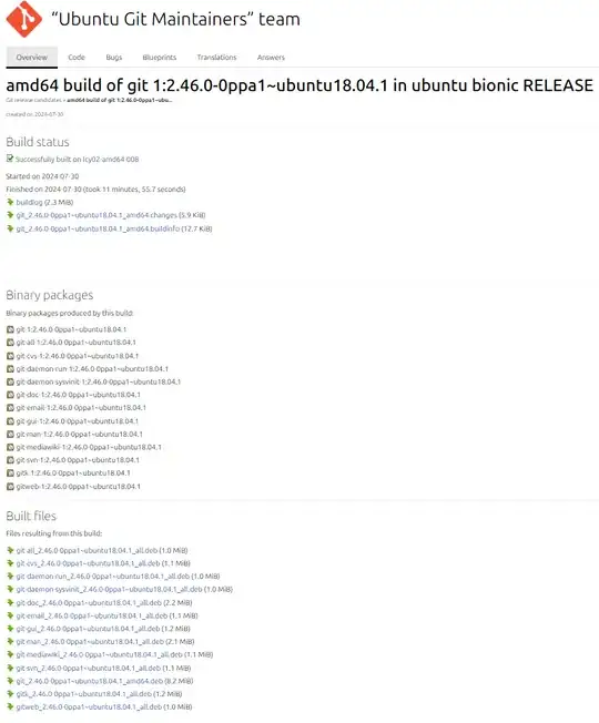

The add-apt-repository solution didn't work for me (lots of moaning about ssl certificates). Instead I managed to get it updated by installing a backport:
Work out what release and architecture you need
lsb_release -a and uname -m will reveal the name of the release and the architecture. Mine were bionic (18.04) and amd64 (aka "x86_64")
Download the new package for that combination
I found the exact files I needed on launchpad by drilling down to those parameters from
https://launchpad.net/~git-core
to
https://launchpad.net/~git-core/+archive/ubuntu/candidate/+build/28694527 launchpad page for git on bionic amd64
Install the dependencies
dpkg -I git_2.46.0-0ppa1~ubuntu18.04.1_amd64.deb will reveal what the dependencies are. Or you can just run the install and it will tell you.
I had to install libpcre-2-8-0 which, fortunately, I could do in the standard way: sudo apt install libpcre2-8-0
Git requires the manual page, which is in a separate package "git-man" so download and install that first.
dpkg -i git-man_2.46.0-0ppa1~ubuntu18.04.1_amd64.deb
Install the git package
dpkg -i git_2.46.0-0ppa1~ubuntu18.04.1_amd64.deb
Thus I have managed to move from git 2.17 to 2.46
