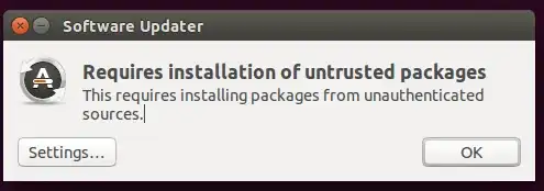

When trying to install packages through the software updater on Ubuntu 14.04.1 LTS I get following error:
Software Updater error
It's about these packages: Software Updates packages
I have selected following settings from where to install updates from: Software & Updates settings

You could run:
sudo apt-get update && sudo apt-get dist-upgrade

To fix the duplicate entry in your sources.list file:
Open it in an editor with root/sudo rights e.g:
sudo nano /etc/apt/sources.list
and remove the duplicate line (does not matter which):
http://dl.google.com/linux/chrome/deb/
Then use ctrl-x to exit (y to save). Do an apt-get update and upgrade as you normally would.

  1. Open 'Software & Updates' and go to 'Other software'.
  2. Uncheck the software which is showing error while updating.
  3. Refresh and rerun the update.

Comment those lines, of which this error is producing.
Open Terminal (Ctrl+Alt+T) an run the following commands.
Change to the /etc/apt directory:
cd /etc/apt/
Edit the file sources.list:
sudo nano sources.list
Comment the lines with # symbol which is mentioned in the error log.
Once update the sources.list file, upgrade your software by using the following command line.
sudo apt-get clean
sudo apt-get update
sudo apt-get upgrade
