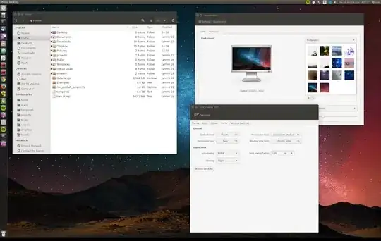

As you can see, Nautilus font has suddenly stopped respecting the OS defaults. It happened by random after a boot today. Resetting fonts to default does not help.
Any ideas what's happening?
Edit: Link to full image https://dl.dropboxusercontent.com/u/2188345/fonts.png

This happened to me after installing the ttf-mscorefonts-installer package. I tinkered a bit and now Nautilus looks right again (it's back to using the Ubuntu font, as it normally does in Ubuntu).
Here is my procedure:
1) I opened a terminal and executed this fontconfig command:
$ fc-cache -rv
2) After the command finished, I logged out and logged back in.

I have faced the same problem when replaced my HDD with SSD. Fonts started looking just like in your pictures! I solved this by disabling the Ubuntu user auto-login in a system. When I switch my laptop, I have to enter password to see desktop but fonts and themes are now looking correct.
