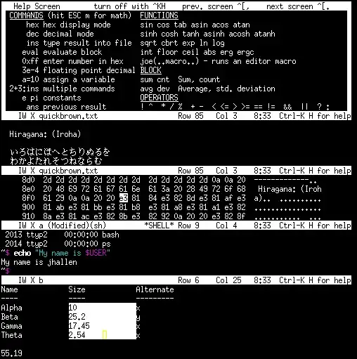

Joe
Back in the 1990s many of my colleagues preferred Joe to either vi, pico or emacs. It is still considered by some as the most user friendly terminal based text editor.
JOE is a full featured terminal-based screen editor which is distributed under the GNU General Public License (GPL). JOE has been around since 1988 and comes standard with many Linux distributions.
Joe is not installed by default but is available from the universe repository:
sudo apt-get install joe

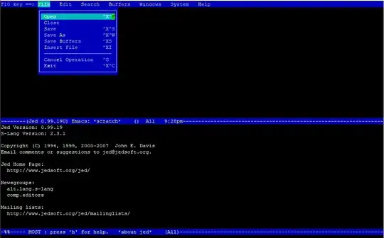

Can I also suggest 'jed' console editor, a bit like 'ne' in some respects with menus (accessible via F10), simpler overall (less fully-featured) and with a bit of colour.
sudo apt install jed
Jed Editor
