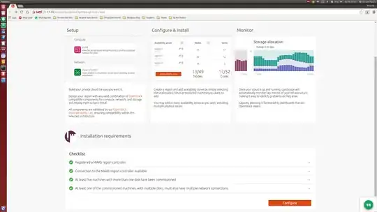

I've completed almost all steps about the installation of Canonical Distribution realized it on an Virtual Environment.
At the end the procedure I see Landscape Dashboard deployed of Juju. This is the situation of MaaS

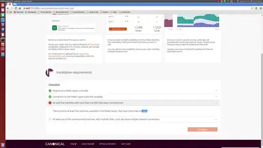

if I scrolled down the page the result has been that
I've added the second HD on all the VM and re-put them in ready state on MaaS, then I've run Openstack with Landscape.... but the error is always the same.
How do I have to upgrade the configuration to see also the second disk and resolve that?

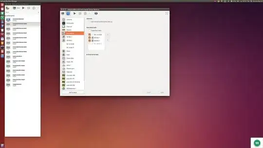

I've found this solution
Landscape OpenStack Installation Requirements Checklist

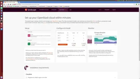

changed the bus disk from virtio in IDE on virt-manager for each vnode I've resolved that.
Now all Checklist are green
