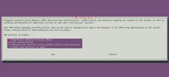

The server I was working on was configured with some sort of Windows Authentication through PowerBroker Identity Server(PBIS).
Basically when I input sudo pam-auth-update, the following options appear:
Output of <code>sudo pam-auth-update</code>
  1. Unselect the first item of the list using the Space Bar Key to Select/Unselect, and Up/Down arrows if necessary.
  2. Then move to the Ok Option using Tab, and Left/Right arrow keys if necessary.
  3. Press Enter on top of the Ok Option.
  4. After this, I could use passwd and adduser as normal
  5. Once you are done with your user configuration, you can go back to sudo pam-auth-update, and leave the settings as before.
In the general case (i.e. not using the PowerBroker Identity Server(PBIS)), it seems to be important to have the Unix Authentication activated (and no other authentication system).
