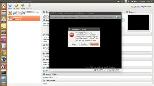

Tried to start the VM from GUI, and I took only this clue:
I pressed "Continue" and nothing happened but a black empty screen. Any solution? Why cannot I run 64bit VMs with a 64bit CPU???
The reason we can not run a 64-bit guest in Virtual Box even when run on a 64-bit host is that 64-bit guests don't make use of software virtualization. They depend on hardware virtualization to work:
VirtualBox's 64-bit guest support (added with version 2.0) and multiprocessing (SMP, added with version 3.0) both require hardware virtualization to be enabled.Virtual Box Manual
In case our CPU supports it we need to enable it in the BIOS of our computer:
In case our CPU does not support hardware virtualization we are unable to run 64-bit guests. We will still be able to install and run 32-bit guests.
