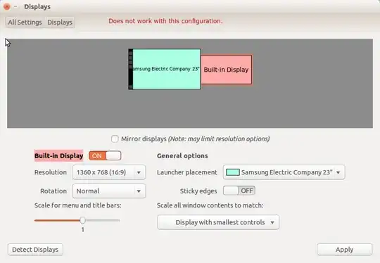

This is odd. The hot corner works if my built in display is set to the left, or below the second monitor.
Screenshot of Display setup
If the built in display is set to the right of the second monitor the hot corner does not work.
Screenshot of Display setup with hot corners not working

You resolve this issue be making sure the hot corner is accessible by your mouse in the viewport.
via comment from Jacob Vlijm,
for Unity (Compiz), your screens together make one viewport/desktop. In your second setup, the right side of the left screen is just (a bit further than) half way of your desktop, as seen by Unity.
