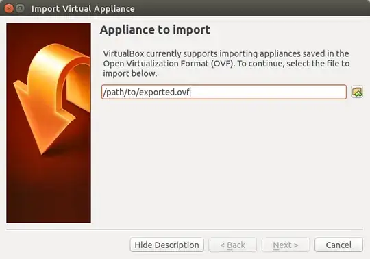

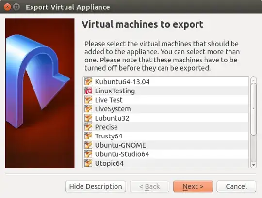

  • To register the VM in the new host Virtual Box we need to first export the VM appliance as OVF to our harddrive or (recommended) to an external storage. Merge snapshots before exporting as they will not be preserved.
  • Then we can proceed with importing them to the new host.

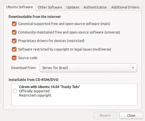

First, enable the multiverse repository (which contains VirtualBox).
Enable Multiverse (Graphically)
  1. Open "Software and Updates":
  1. Make sure Software restricted by copyright or legal issues (multiverse) is enabled.

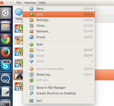

Import your VM
Open Virtualbox, then go menu Machine > Add.
Browse and select your .box file and click on Open.
Repeat for all VMs.
