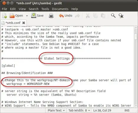

Open a Terminal window and type the following command: gksudo gedit /etc/samba/smb.conf.
Then, press Enter. If you haven’t previously used the Terminal this session, Ubuntu will ask you to type in your user account password.
Next, the Samba configuration file will open in a gedit window. Scroll down, if necessary, until you find the workgroup line, in the Global Settings section.
Edit the Workgroup name so that it will match the name of the Workgroup you want to add your Ubuntu computer to.
Click on Save and restart Ubuntu so that the new settings get applied.
