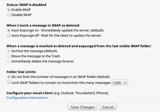

In the Settings on the Gmail website, you can set it to archive deleted messages so whenever you delete a message it will be archived on Gmail's server.
The settings can be found in Gmail -> Settings -> Forward and POP/IMAP with the label When a message is marked as deleted and expunged from the last visible IMAP folder. Here is a picture of the settings, it's the 3rd section.
screenshot of the settings
