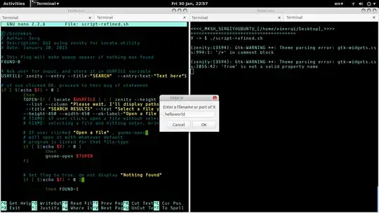

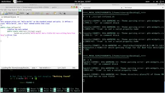

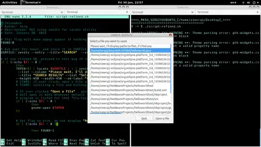

As requested in the comments , I've refined the script, and added the option to open files. Everything is implemented with zenity, locate, and gnome-open. Praise the Unix philosophy of piping commands into others !
I've annotated the script , so it should be clear where, what, and how. In the screenshots I'm opening the Hello World program for java. The script exits at any point if user clicks Cancel/Quit buttons.
Side note: The OP requested that the app should be cross-platform. As far as I know, zenity,gnome-open, and locate are not dependent on presence of GNOME shell. Besides, users will be connecting to his Ubuntu server, and all those apps work on Ubuntu regardless of GNOME shell's presence. In other words, they're going to be executing the script on his system, not theirs, to locate the files.
The refined script:
#!/bin/bash
# Author: Serg
# Description: GUI using zenity for locate utility
# Date: January 30, 2015
# This flag will make popup appear if nothing was found
FOUND=0
# Ask user for input, and store it in USRFILE variable
USRFILE=`zenity --entry --title="SEARCH"  --entry-text="Text here" --text="Enter a filename or part of it"`
# if use clicked OK, proceed to this big if statement
if [ $(echo $?) = 0 ]
    then
    TOPEN=$( ( locate $USRFILE ) | ( zenity --height 450 --width=450\
     --list --column "Please wait, I'll display paths to files, if I find any"\
     --title "SEARCH RESULTS" --text "Select a file you want to open"\
    --height=450 --width=450 --ok-label="Open a file " --cancel-label="Quit" )  )
    # FIXME: if user clicks open a file without selecting one, program will crash
    # FIXME: selecting a file and hitting enter, brings up "Nothing found" dialog
    # If user clicked "Open a file" , gnome-open
    # will open it with whatever default
    # program is listed for that file-type
        then
        gnome-open "$TOPEN"
    fi
    # Set flag to true, do not display "Nothing found"
        then FOUND=1
    fi
    # If we didn't  find anything, display a message
    if [ $FOUND != 1  ]
        then zenity --info --text="Nothing found"
    fi
fi
Screenshots of the refinements
Get user input enter image description here Display search results if any, might take a moment to load enter image description here Open the selected file enter image description here

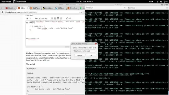

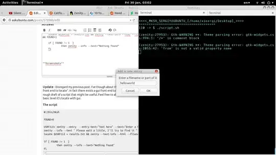

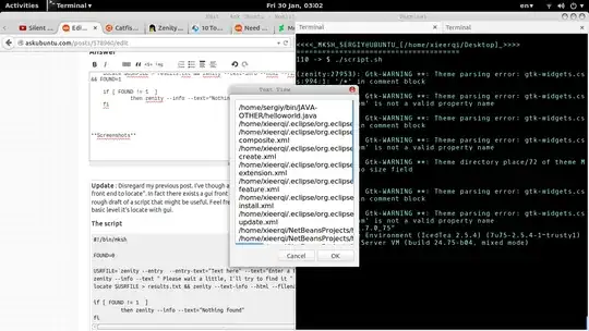

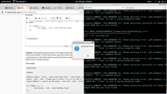

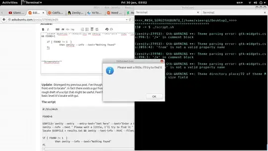

Update #1,Jan 29 : Disregard my previous post. I've though about the way you worded the problem : "a gui front end to locate". In fact there exists a gui front end to scripts , zenity, and I've used it to make a rough draft of a script that might be useful. Feel free to alter it and add functionality, but at the most basic level it's locate with gui.
As for making a script "double-clickable" refer here
The script
#!/bin/bash
FOUND=0
USRFILE=`zenity --entry  --entry-text="Text here" --text="Enter a filename or part of it"`
zenity --info --text " Please wait a little, I'll try to find it "
locate $USRFILE > results.txt && zenity --text-info --html --filename='results.txt'
if [ -e results.txt ]
        then FOUND=1
        rm results.txt
fi
if [ $FOUND != 1  ]
fi
Screenshots
enter image description here enter image description here enter image description here enter image description here enter image description here

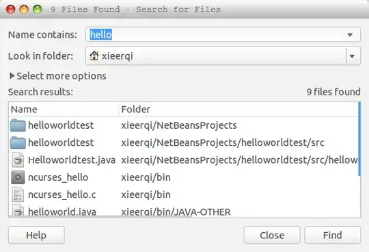

There is gnome-search-tool, which I've checked with ps and htop utilities and it doesn't take too many resources. You can install it with sudo apt-get install gnome-search-tool.

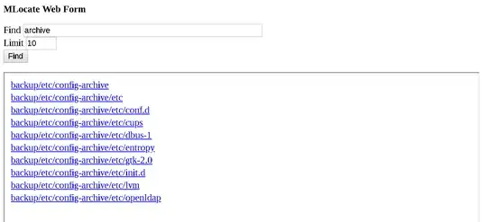

I know this is pretty old but I just found myself asking the same question for some cold storage on a Raspberry Pi. I came up with a super simple solution with CGI but beware - security isn't its strength. Only use this for a personal system or private network because it's ripe for injection attacks. The good news is it's fast and easy to deploy if you already have Apache/NGinx installed.
search.html:
<HTML>
<TITLE>MLocate Web Form</TITLE>
<BODY>
<b>Simple Web Form</b><p>
<FORM ACTION="/cgi-bin/search.cgi" target="resultsframe">
<label for="search">Find</label>
<INPUT TYPE="TEXT" NAME="search" SIZE="50"><BR>
<label for="limit">Limit</label>
<INPUT TYPE="TEXT" NAME="limit" value="10" SIZE="4"><BR>
<INPUT TYPE="SUBMIT" NAME="Find" VALUE="Find">
</FORM>
<iframe name="resultsframe" height=600 width=800></iframe>
</BODY>
</HTML>
Now you can just use CGI to dump the results from a bash script (/var/www/cgi-bin/search.cgi):
#!/bin/bash
echo -e 'Content-type: text/html\n\n'
echo '<html><body><table>'
eval $(echo $QUERY_STRING | sed 's/\&/\n/g')
while read -r l
do
    l=${l:8}
    echo "<tr><td><a href='[YOUR_HTTP_BASE]$l'>$l</td></tr>"
done <<< $(locate -l "$limit" -i "$search")
echo "</table></html>"
Results are posted as links so filter and map your results to apache-permitted paths you want. If you have unicode or html-iffy characters, best to escape them. Also note that you can potentially inject nastiness into your search here so use at your own risk or sterilize the input.
Sample screenshot
