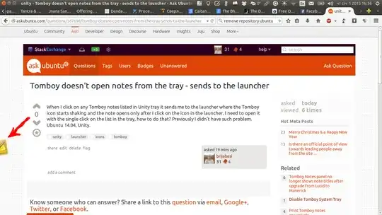

When I click on any Tomboy notes listed in Unity tray it sends me to the launcher where the Tomboy icon starts shaking and the note opens only after I click on the icon in the launcher. I need to open it with the single click on the list in the tray, how to do that? Previously I didn't have such problem. Ubuntu 14.04, Unity.
