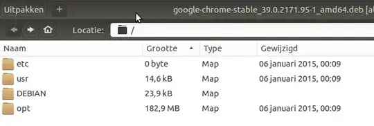

Looking inside a .deb installer file with archive manager, you can see where files and (possibly) directories will be installed:
In this example, files will be installed in /etc, /usr and /opt (the folder DEBIAN contains installation files, see further below)

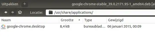

Browsing deeper into /usr, you can see the .desktop file (represening your application in Dash) is installed in /usr/share/applications/

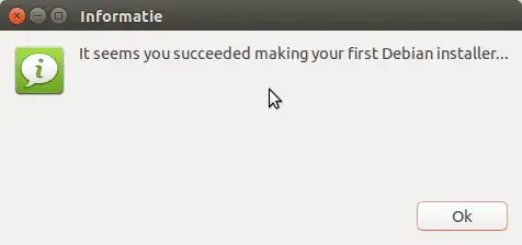

Our example application will only show you a window, saying you succeeded:

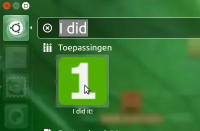

If all went well, you can run it from Dash.
