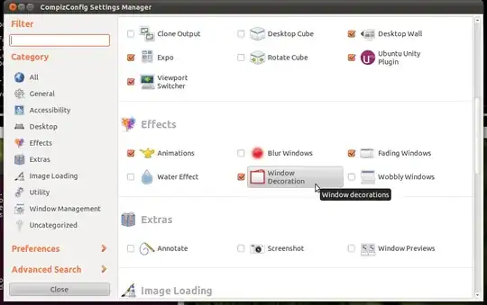

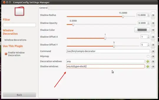

If you want to keep shadows on windows but remove them from the panel,
Install compizconfig-settings-manager
you can use go to Window decoration
and set Shadow windows to (any) & !(type=Dock).
You can do this with compizconfig-settings-manager
sudo apt-get install compizconfig-settings-manager
run it and go window decoration settings. Set window shadow to 'none'.

Just type or copy paste this: "any & !(type=dock)" under 'Shadow Windows' option in CCSM Window Decoration.
