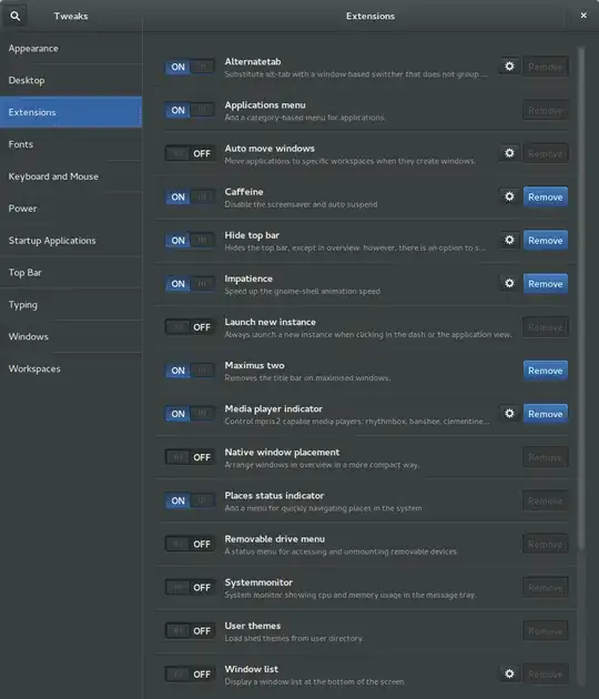

These are the list of extensions I have installed:
List of installed gnome shell extensions - part1 List of installed gnome shell extensions - part2

  • It is the Window List plugin the same one used in Gnome Shell standard session which comes within gnome-shell-extensions package. It's full name:
    window-list@gnome-shell-extensions.gcampax.github.com
    Installed in: /usr/share/gnome-shell/extensions/
  • What it seems happening is .. the Gnome Classic session use it as a required plugin. So it does ignore disabling it. (Using gnome-tweak-tool)
  • To get rid of it, move it somewhere else or delete it
    sudo rm -r /usr/share/gnome-shell/extensions/window-list@gnome-shell-extensions.gcampax.github.com
  • To re-enable it, copy it back or reinstall gnome-shell-extensions.
    sudo apt-get install --reinstall gnome-shell-extensions

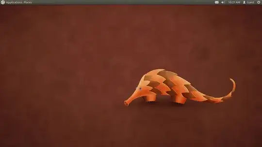

Set the panel which you want to stay visible with Tried in Ubuntu 12.04:
$ gsettings set org.gnome.gnome-panel.layout toplevel-id-list "['top-panel-0']"
which will leave you with only the top-panel like you see in the snapshot below.
snap1
(With that done I wasn't able to Super + W or Alt + tab the minimized windows. But I haven't checked with other dock apps.. I suppose they'll work.)
