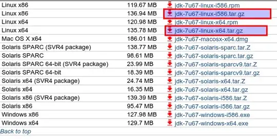

Now you will get this page. And you see something like screenshot below. Choose tar.gz depending on your architecture, I highlighted two of them that fits Ubuntu:
picking java
Oracle may ask you to sign up before download
