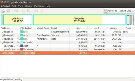

Here's how the partitions are structured in my machine:
Gparted Snapshot
/dev/sda1 --> That annoying 100mb drive that windows makes in your computer
/dev/sda2 --> System drive of my windows installation
/dev/sda3 --> All my stuff is here
/dev/sda4 --> Ubuntu drive.
My Question:
Can I merge /dev/sda2 and /dev/sda4 without messing up /dev/sda3 and /dev/sda4? Also, do I have to do something like Removing Windows before deleting /dev/sda2?
You can only merge partitions that are next to eachother.
No. If you delete sda2 you basically delete Windows.
What I would do since there is no need messing around.
and then ...
  • delete sda2.
  • format it as EXT4.
  • mount /home/ in sda2.
The more difficult method ...
  • delete sda2 and leave unallocated
  • add that space to sda3
  • shrink sda3 so that the empty space is at the end of sda3
  • add space to sda5
That will take hours and hours and hours to finish (the less free space there is the longer this will take since files will be moved to the beginning of sda3).
