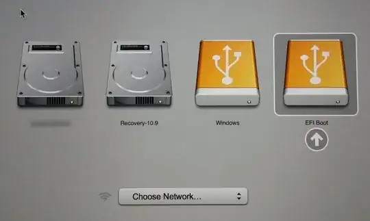

Boot from the Live USB
The trick to booting from USB on Macs is to hold down the option key as soon as you power on the device. Select EFI Boot from this menu.

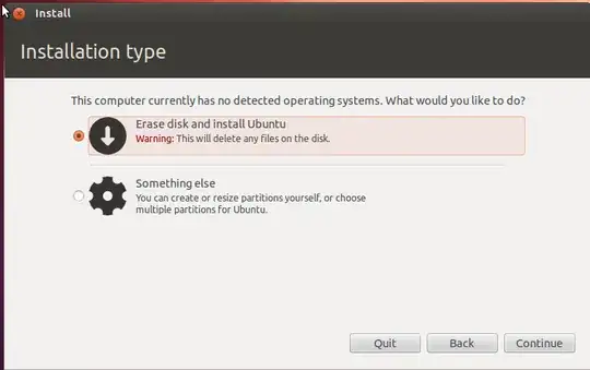

Ubuntu should now boot up from the USB. Install Ubuntu using the Erase and use Entire Disk option.
