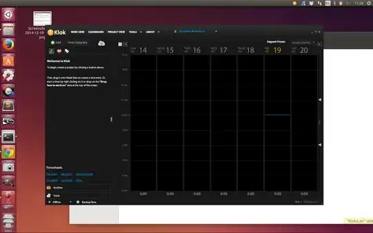

This screenshot shows Klok 2 working on Ubuntu 14.04 LTS (Klok 2 is running on Adobe Air 16 which is running on WINE): https://www.flickr.com/photos/therobyouknow/15868611448/
