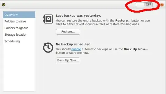

If you want to retain deja-dup for manual backups, but don't want the monitor task running, simply switch off the monitor function by clicking the button in the upper right hand corner of the deja-dup control window.
This gets rid of automatic backups and the monitor task, but allows you to take and restore backups at will.
