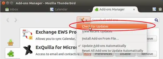

  3. In Thunderbird, click menu-->Add-ons
  4. Click the icon to install an add-on from a local file (fig 1 below).

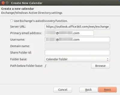

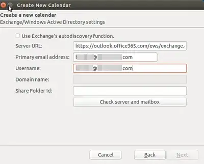

  9. Now the tricky part. I could not get the autodiscovery feature to work, but if you enter the correct server url and username, you're good to go. For office 365, the url is: https://outlook.office365.com/ews/exchange.asmx. See figure 2 below.
  10. Click "Check Server and Mailbox". If you got the server and username right, the folder base input should appear With a Next button (figure 3). Click Next. Everything seems to work from this point. Good luck!
Figure 1 -- Install a the downloaded exchange plugin
Install the locally saved exchange add-on
Figure 2 -- Configure the Exchange Settings
Configure the exchange settings
Figure 3 -- After clicking "Check Server and Mailbox", the folder base input appears with a "Next" button
Correctly configured exchange server -- yay
