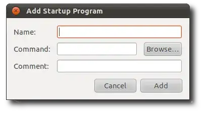

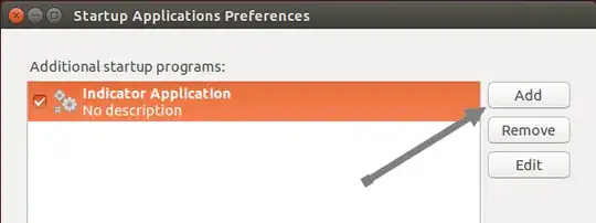

Go to startup applications -
Click on the Add button -
and fill out the fields in the following manner -
Command: /opt/viber/Viber
Comment: Connect. Freely.

GUI method:
You can achieve what you want by going to the Startup Application Preferences from dash and create a NEW startup item. Just click on the Add button, which brings up an input dialog. In that dialog, you specify a name to call it, an optional comment blurb, and the command to execute(will be /opt/viber/Viber), which would be the path of Viber. When you're done, a new NAME.desktop file will appear in ~/.config/autostart.
