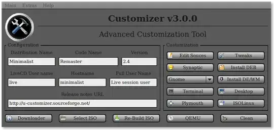

You can Use:
Customizer
It allows you to customize them the way you want to within the matter of few minutes (on a modern PC) running Terminal, Synaptic, Desktop session (in chroot environment) and even more so you can modify the images to fit your needs.
To Install it:
  sudo add-apt-repository ppa:customizer-dev-team/devel
  sudo apt-get update
  sudo apt-get install customizer
