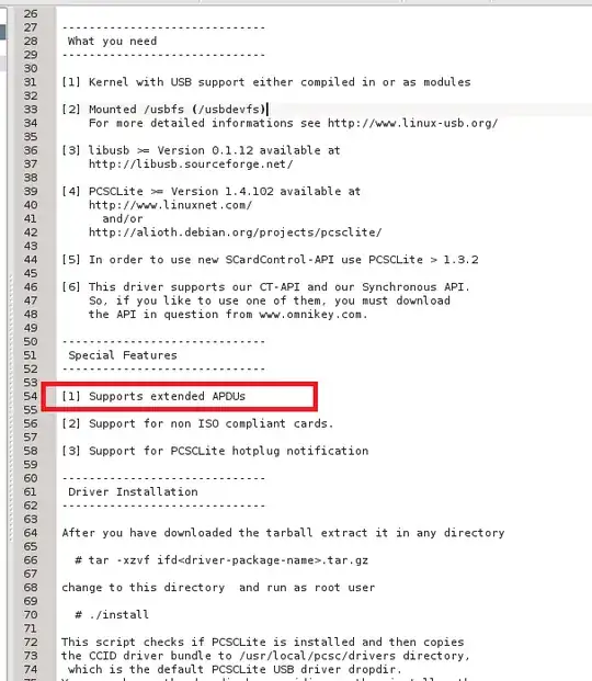

So i downloaded the Linux driver from the Cherry-Website.
(http://www.cherry.de/files/software/ifdokccid_lnx_x64-3.5.1.tar.gz)
(in the drivers readme is to read: SUPPORTS EXTENDED APDUs! (this is what i need!))

The driver-package does only contain one "binary" file (ifdokccid.so) and a few scripts in different folders.
Questions is:
How can i find out if the "driver"-file (ifdokccid.so) is really used?

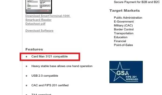

After trying to find out why it doesn't work, i found following info on Cherry-International-Website (not DE site):
So, i went to OmniKey-Website and downloaded the driver for OmniKey CardMan 3121.
http://www.hidglobal.com/drivers/21278
After installing it, it works like a charm!
