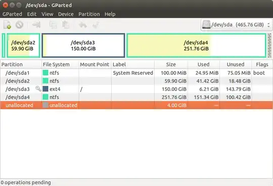

I installed my OS but did not create a swap space. I now realize it is a problem. I have a 4GB ram and I will running huge applications. The below is the snip of my gparted. I opened Gparted but could not find swap on. I saw the accepted answer to this question. Will it work for me. In laymen terms, If I use those two commands can I forget about swap space and related things. Even more laymen, If I shutdown my system and restart it, will i then have to worry about swap space.

Using a swap partition: Seeing as you are using an MS-DOS partition table, you can not have more primary partitions. In order to make a swap partition, you will have to 'temporarily' delete one of your partitions. So first back up your data from that partition, then in gparted, delete the partion.
Right click on the now unallocated space and create a new partion, make sure to choose 'Logical' partition.
This logical partition can contain a lot of primary partitions, so now you can create a partition similar to the one you deleted, and add the swap partition next to it.
Once the swap partition is created, you can activate it with sudo swapon /dev/sda5 (replacing /dev/sda5 with the actual name of the partition).
