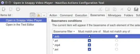

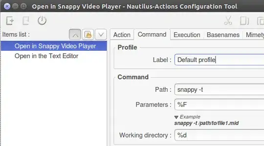

Limited idea of an answer.
Maybe a way would be to use the terminal commands through the context menu, for example in Nautilus with Nautilus-Actions.
snappy -h says: -t, --subtitles Use this subtitle file
So, then in nautilus-actions:
And limiting that to specific files
When selecting both the video and the subtitle file and right-clicking, the new nautilus action will start the video in Snappy with subtitles.
(But I don't think the display of the subtitles is editable. They look small and fuzzy.)
