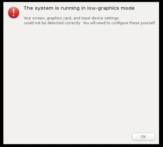

Following this tutorial, I managed to change the environment from "unity-greeter" to "gnome-fallback-compiz" and then I rebooted and I got this:
Yeah, and all the options are pretty much useless to me which means delete and install. This is actually a clone of my Ubuntu VM so no progress has been lost :) but I never had an issue like this in 12.04, the previous LTS. Maybe I should try gnome-fallback instead of gnome-fallback-compiz but then its not compiz but really at this point I don't care. Any suggestions about this?
Try with this Gnome3 shell, remove the gnome-fallback-compiz Remove this in terminal, DON'T purge anything and install: sudo apt-get install gnome-shell ubuntu-gnome-desktop

The issue was that I was editing the wrong file. I was editing the greeter file rather than the file used in the tutorial.
