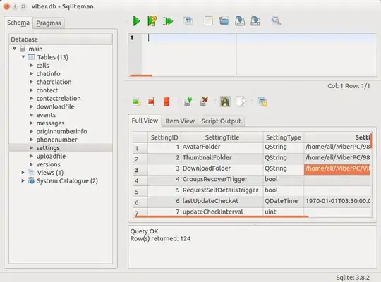

Viber preferences are stored as ".db" files under ~/.ViberPC/. You should have installed an extra application in order to open or edit them; for example, Sqliteman which is available from Software Center.
To edit the location of downloads folder, open the following file:
~/.ViberPC/{your-phone-number}/viber.db
On the left sidebar of Sqliteman, open Tables > Settings. You can see the setting entitled DownloadFolder on the bottom right. Double click on its value to change the location as you wish.
Sqliteman window
If you have downloaded some files before you change the setting, you won't be able to open them from Viber afterwards. To solve this, @HeyYo have a great answer.
