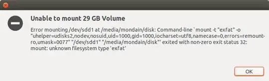

I am using a Kingston MMC USB reader with a Samsung 64Gb microSDXC UHS-I card. The first time I inserted it, this dialog appeared: enter image description here
So I searched around and found a similar q/a here; I performed the steps in the answer for the question: Unable to access 64gb volume - Ubuntu 14.04
Now the error dialog does not appear any longer, but the 64Gb card only mounts as 29Gb volume now.
