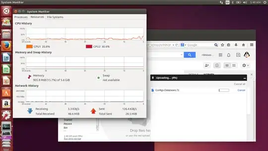

File upload starts without problems

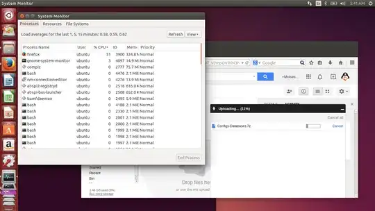

But all my files stops at 10 to 15% (pay attention to CPU graph)
File stops at 10 to 15%
after that, the browser process goes to 50% and my upload stops and after some minutes is restarted and stop again at 10% :S
