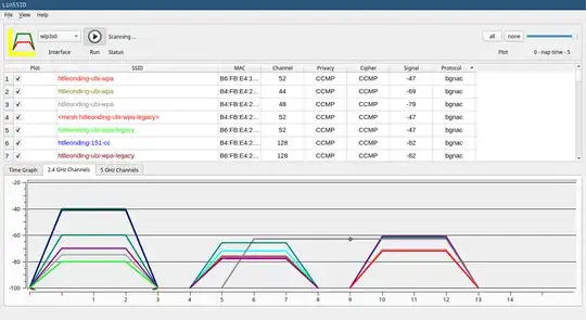

Use LinSSID, a GUI program that will give you information about MAC addresses, channels and power signals.
Example screenshot of LinSSID:
