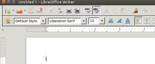

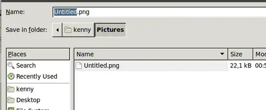

I don't know what I did, but it seems that most of my programs are now using some poor old window design:
LibreOffice
Gimp
Firefox

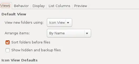

But for example nautilus doesn't have this problem :
Nautilus
Would anyone know what this is due to?

Hopefully, you already got the solution, however, I was also having this problem and came across this question.
I also continued searching because there wasn't an answer here. The problem turns out to be that you need to restart the windows manager.
I was able to do Alt + F2 type unity then press Enter. As mentioned in this answer.
However, there is also a more detailed response above the response I linked above with more detailed commands and explanations (in case the above doesn't work).
Good luck, if you made it here! Hopefully, this works for you if you were facing the same problem as me (or maybe even the questioner).
