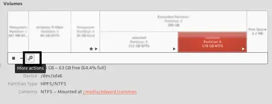

  • Open up Disk program from dash. click on the partition and then click on gear icon below (as shown)
Disk program ubuntu
you will get many options, click on Edit mount option.
  • a small window will open then toggle Automatic mount option to OFF
  • if you want to change the location of mounting, give a path in mount location ( i recommend mouting in /media folder this will make the mounted partition to appear on side in nautilus). you can also change the name by which it will be mounted in Identify as ( i recommend using label)
  • then press OK.
