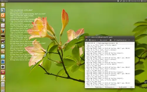

Now start editing your text file. Every five seconds, the wallpaper is updated if needed (after you saved the changes):
Examples
1 column, max 30 lines per column

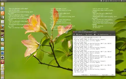

2 columns, max 20 lines per column

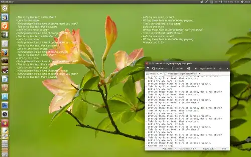

3 columns, max 10 lines per column
