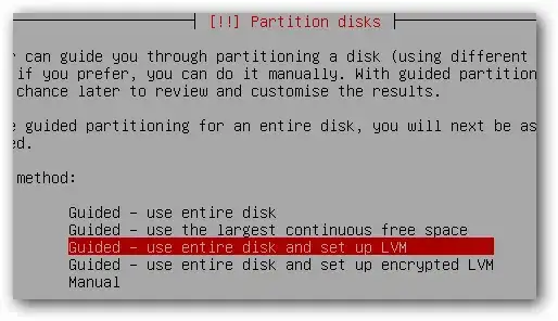

You have not installed ubuntu using LVM partitioning. If you had used LVM then df command should return something like
$ df -h
Filesystem                  Size  Used Avail Use% Mounted on
/dev/mapper/localhost--vg-root  7.0G  1.7G  5.0G  25% /
none                        4.0K     0  4.0K   0% /sys/fs/cgroup
udev                        232M  4.0K  232M   1% /dev
tmpfs                        50M  356K   49M   1% /run
none                        5.0M     0  5.0M   0% /run/lock
none                        246M  4.0K  246M   1% /run/shm
/dev/vda1                   236M   75M  149M  34% /boot
Unfortunately there is no easy way to increase main partition. You could:
  • Boot from some live-cd to redefine your partitions (Be careful of your data)
  • Reinstall using LVM partitioning
