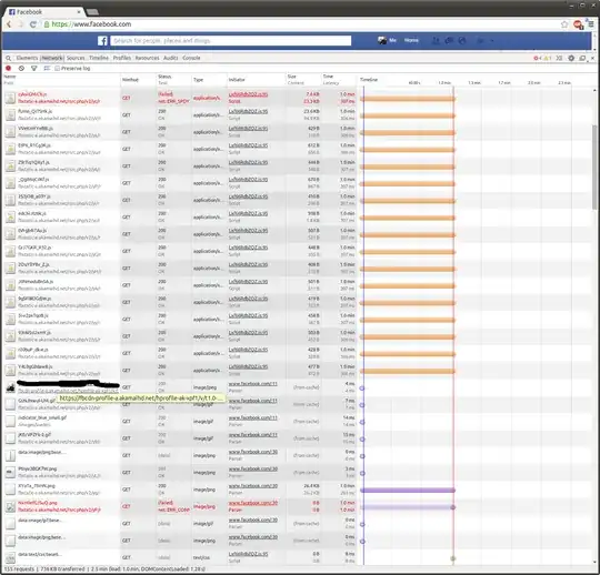

Edit: Here's a screenshot of the network traffic. Curious how the requests all terminate around the same time.

I see you're using AdBlock in the screenshot above. I wonder if it's causing some of the slow down? Have you tried surfing without AdBlock?
