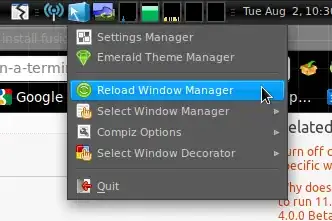

You can also use the Compiz Fusion Icon, which can easily be installed by dropping in a terminal the next:
sudo apt-get install fusion-icon
And after providing your password the fusion icon will be installed and a shortcut can be reached inside of the "System Tools" menu in the majority of the cases, if not, in a terminal drop the next:
fusion-icon
and in the Fusion Icon menu (right click), choose "Reload window manager" in order to force Compiz to reload, after which all your compiz features will get enabled and should not break after closing the Fusion Icon (even from Terminal).
