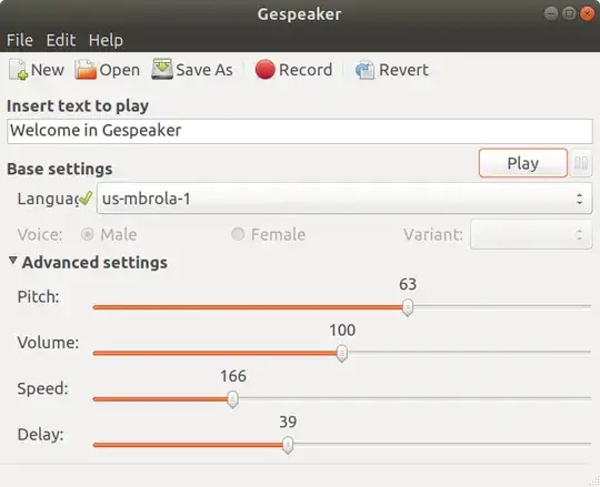

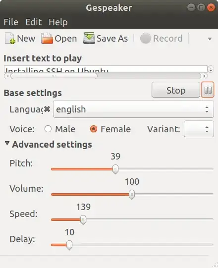

Hi all, I have been looking for ways to improve the espeak user experience including modifying/adding new voices and came across this article regarding Gespeaker which is a graphical interface for espeak. It's easier to use especially for bits of text which you can cut and paste from a webpage and have read. To expand the text window to accommodate large chunks of texts click on the "advanced settings" button (see image).
There is an option for variant in the voice section (where you have male and female - which work). I don't know how to make use of this to add a variant (of a voice?). I will update this if I find a way.

Restart Gespeaker.
You should see the voice appear amongst the existing espeak voices in the language bar of Gespeaker. See the image below. enter image description here
I still don't know how to employ the "Variant" option.
