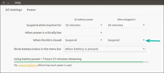

For 16.04 and above:
First, you need to make sure that you enabled suspend mode when the lid is closed. You can see it from Settings-Power enter image description here
After you are sure about this, you need to type some commands.
sudo apt install pm-utils
sudo cp /etc/systemd/logind.conf  /etc/systemd/logind.conf.back
sudo nano /etc/systemd/logind.conf
Here, you download a tool that handles some suspend&hibernate actions. After that you create a backup for logind.conf file just in case.
At last, you will edit the logind.conf file for some changes. When it opens, you will see that all commands are commented with "#" sign. We will remove some "#" from these lines.
HandleSuspendKey=suspend
HandleLidSwitch=suspend
HandleLidSwitchDocked=suspend
remove the # signs from these lines and save it. Reboot the computer and see that if it works.
This solution is worked on me on MacBook Air 2015 with Ubuntu 18.04 on it.
