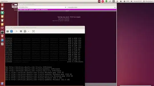

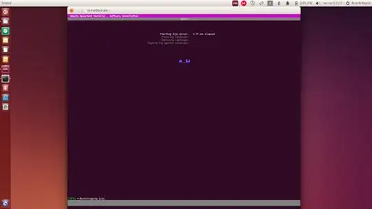

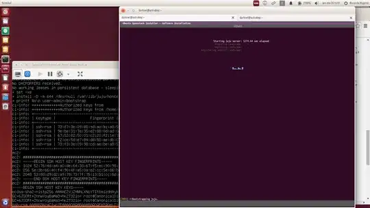

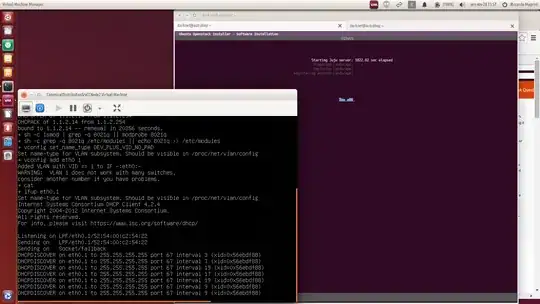

after that the node made the reboot and during the boot I saw that
after some minutes the installer went head
the node means ready but after few seconds went down, and on .commands.log the log is this
