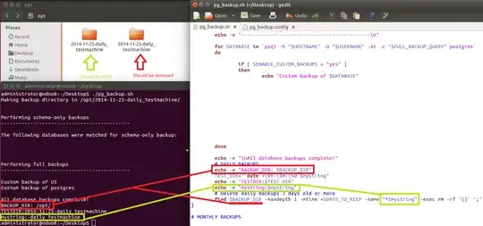

To make things more clear I've made a screenshot to show the setup:

My error was a logic error with -mtime. I thought my script was checking the names but -mtime checks for the date when the file was created. So my final code:
DAYS_TO_KEEP=2
find $BACKUP_DIR -maxdepth 1 -mtime +"$DAYS_TO_KEEP" -exec rm -rf {} \;
I just had to do a sudo touch -d "3 days ago" /filepath/folderToRemove to make -mname find the folder and make sure the file was old enough to be removed. So this final code removes all folders that are older than my variable $DAYS_TO_KEEP
