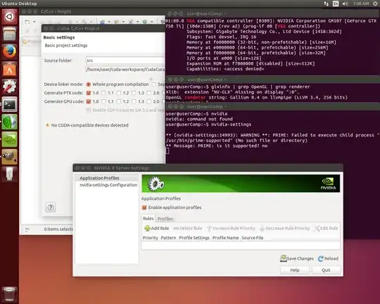

I currently am now at the point of an install seen below, also under "System -> Software & Updates -> Addditional Drivers" it shows no additional drivers. enter image description here
Now this is the point at the install that I would restart and try to log back in and see if NSight Eclipse would recognize my GPU as a CUDA enabled device. But I am afraid I will not be able to log back in as usual.

EDIT2: Running the command dconf reset -f /org/compiz/ from the first edit displays an error from "Cannot autolaunch D-Bus without X11 $DISPLAY". As for the tests from the 5th step. On the first the output from the lspci -vnn | grep -i VGA -A 12 is too long and I am not sure how to scroll up I'm a newb. For the second glxinfo | grep OpenGL | grep render returns an error "Unable to open display".
I am not sure what the command specifically does but I have seen it in some of the links today export DISPLAY=:0. I ran this and then ran the dconf reset -f /org/compiz/ successfully but setsid unity errors saying "Plugin opengl not loaded, Plugin init failed: unityshell" ... " Compiz (opengl) - Fatal: glxQueryExtensionString is NULL for screen 0".
