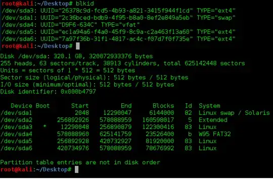

Its been 2 days since i started this and after several re installations it starts to feel like its making some progress.
Below there are some pictures of how my configuration looks like and it's still sloppy, however my laptop is running both Kali Linux and Linux Mint Debian Edition where they both are sharing the same swap and home directory.
Next, I plan to (hopefully) configure the fat32 partition in green (sda4) for LUKS encryption to test with the emergency self-destruction feature that I've been hearing about.
Anyhow, these are the steps that I took to what I call two distros and one cup (common unified paths) where the goal is to eventually share several directories such as /boot, /home and swap partition.
I figure that I most likely to use Kali Linux as root user and Linux Mint as regular user.
First, I made a clean new partition (after accidentally deleted my whole system) as shown from my blkid and fdisk -l commands below.
