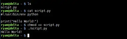

  1. Add #!/usr/bin/env python to the top of the file and save it as script.py.
  2. Open up the terminal.
  3. Set the file's executable bit by running: chmod +x script.py.
  4. Run the script with ./script.py.
