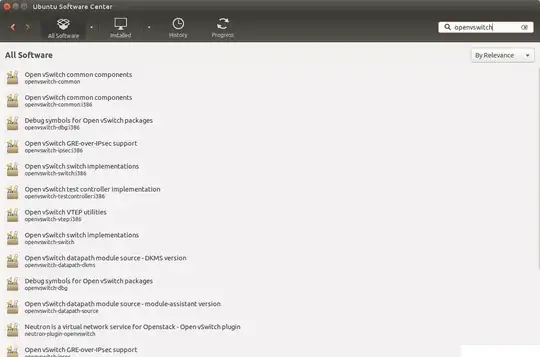

Do not download the tar file (link downloads v2.3.0) (other releases) because there are some important pointers AND at the end of writing this (made it on the fly) I found out it was easier than you would think (though the installation is so obvious I wasted time making this ;) ). Skip to below the image if you do not want to install the source version (ie. the download on their website).

So the manual suggests that there are debian packages (of course... I should have started checking Ubuntu Software Center). So let's open up Ubuntu Softeware Center and search for it.
So to answer your question:
Can any one introduce me to a good and simple tutorial about installing Open Virtual Switch directly via the Linux kernel?
It seems the answer would be yes (it consists on 2 packages available in your software center) so you can do it from our software center or from command line:
Installation made easy
Depending on your needs you may need more components but the base installation will be:
sudo apt-get install openvswitch-switch openvswitch-common
Refer to the install guidelines in the tar.gz or the descriptions in our software center or the website your linked for more information about packages related to this installation.
