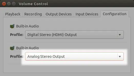

  2. Disable duplex audio profile in pavucontrol Install pavucontrol:
    alternatively either mute audio input, or select a non-attached input (e.g. line)
