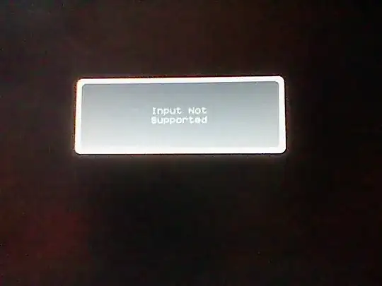

I used to get the (ugly-looking version of) Plymouth graphical boot screen while under 10.04. It didn't look that great, but I was fine with it. Now, it doesn't show on 11.04 at all during boot (I just get an error message in a moving gray box from the monitor saying "Input Not Supported"), and only rarely it will show on shutdown, all garbled up. I could not get GRUB to show during boot while holding down Shift, either (same error message), but pressing Enter while it should be up starts the system normally.
A picture of the error message I was getting: A picture of the issue (please excuse the poor quality, a Nintendo DSi camera was all I had on hand)

CURRENT STATUS: I forgot to uncomment one line as per "things that I've tried" #4, so I took care of that. I can now see GRUB during startup when I hold Shift and a normal-looking Plymouth during shutdown...but Plymouth during boot is now just a solid purple screen. In each case, it's displayed a little off-center to the left, with a thin black bar running down the right side of the monitor. The error pictured above no longer shows. I'd say this problem is about 2/3 solved now.
UPDATE: After Natty started freezing up on me, I decided to dual-boot with Oneiric, which unfortunately shows the same problems. Rather than trying all these workarounds though, I decided to do what I should have done from the start and file a pair of bug reports.
LAST UPDATE: Bug 850908 has been confirmed as a legitimate nouveaufb bug. I have overwritten my 11.04 partition with 12.04 LTS, and I can confirm at this time that the issue is present there, as well. I will now flag this question to be closed, yet I hope it was helpful for anyone who experienced similar issues; if you are still having the same problem as me, please go there and mark yourself as affected. Thanks!
