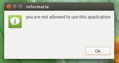

    From then on (after log out / log in) the user will see this message if he or she tries to open gedit from Dash, or tries to open a file that is linked to the application:

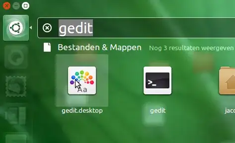

While, after editing the .desktop file, the application will not show up in Dash any more, Dash search will still show our newly created gedit.desktop file, which might unintentionally give a hint how to escape the application block.

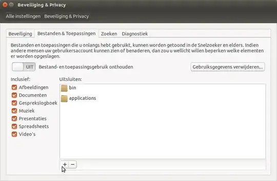

To avoid that, we should exclude the directory ~/.local/share/applications from Dash search and clear the search history.
Open System Settings > "Security & Privacy" > "Files & Applications" (tab). Add the directory ~/.local/share/applications to the list to exclude from search.

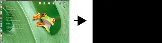

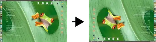

The script either:
blacks the screen (action = "xrandr --output "+screen+" --brightness 0"):
or turns it upside down (action = "xrandr --output "+screen+" --rotate inverted"):
(who said Unity doesn't allow to put the launcher on the right?)
